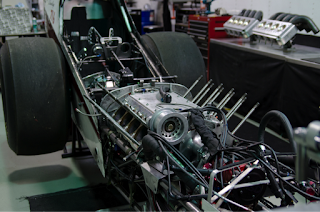

This Mastercam-sponsored top fuel dragster got the first Donovan engine block machined from a billet.https://blogger.goog...g.mastercam.com
