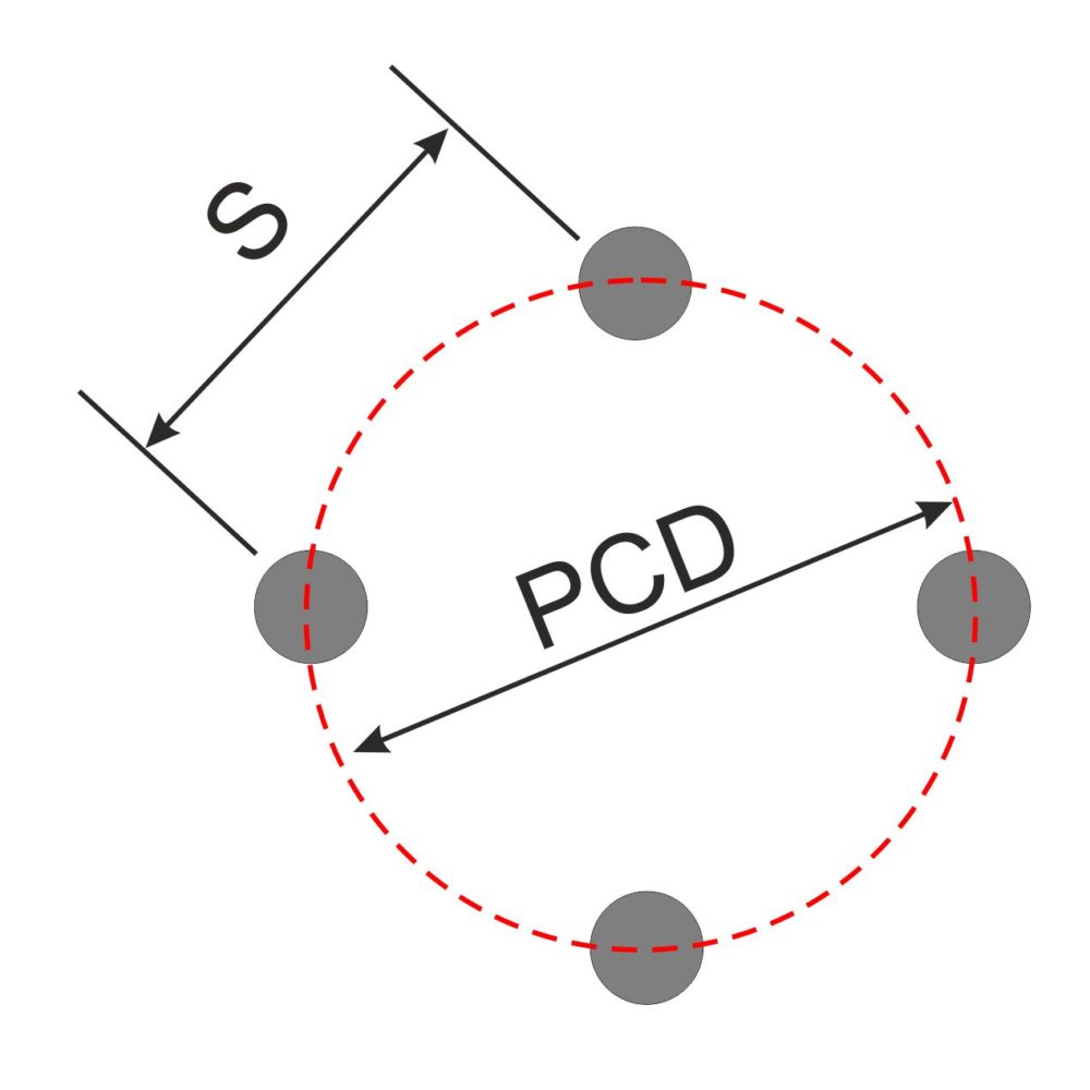

Hi all can anyone help with a simple formula to calculate the pcd of a set of holes...
i know how many holes i have and i also know the center distance between the holes
i just need the formula to find what pcd it is..
i just wanted a quick way of working out a pcd without drawing it up in mastercam
thanks paul

A PCD is more commonly known as a bolt circle.
    B  = D x sin( 360 / (2 x N))
where
    B = distance between bolt holes
    D = diameter of bolt circle
    N = number of holes in circle

thanks for that but its not what im after.
if i have a part that has say 5 holes in it i can measure between the holes and i know how many hooles there are but i dont know the dia that the holes are on..its this unknown diameter that i want to find..

From Dave's equation above:
D = B / (Sin(360/2N))
where
D = PCD (diameter you are after)
B = distance between holes
N = number of holes

Thats it La CAMmer...

The esiest way to find the PCD is :
Find circumference of PCD then divide it by numbers of holes on PCD.
For Example :-
(508 X 3.14) / 30 = S
where S = center to center linear dist. (not curve wise)  between r holes.
By this formula u can easily find the degree also.Posted Image
