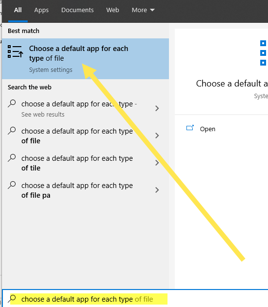

  6. On 7/8/2020 at 11:23 AM, JoshC said:
    please try this.
    1. if you search the start menu for “choose a default app for each type of file” you should see that under system settings as I show in the first image below
    2. From there you should be able to set the .mcam file extension to open with McamVersionSelecter executable
    Thank you so much sir. Worked with Mastercam 2022!
