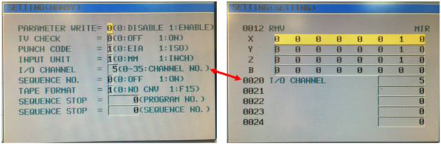

  3.  This bit of info did the trick...
    Yes it is possible to write those parameters. You'll need to know the parameter number though.
    Here's a program to change the comunication channel from 5 to 4, run from the Card, change back from 4 to 5.
    HTH
    O777(RUN FROM MEMORY CARD SAMPLE)
    G90G10L50
    N20R4
    G11
    M198 P1234(PROGRAM TO RUN FROM ON MEMORY CARD)
    G10L50
    N20R5
    G11
    M30
