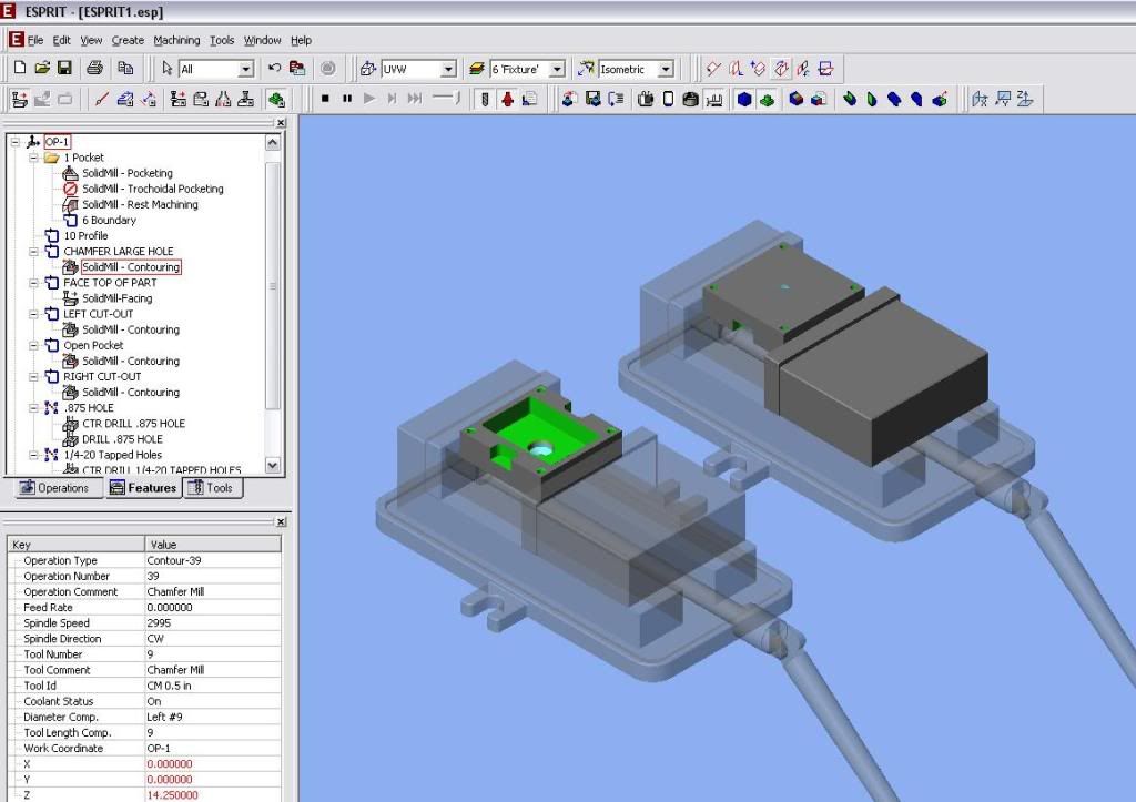

I heard some Mori Distributor are not so happy with Esprit, seems Esprit is leaving it to the dealers to figure out how to train people on the software. There answer...send them to Chicago...
We purchased Esprit over MasterCam since we have a swiss lathe. The owners and myself were assured after one week in Chicago I would be ready to roll right into production the following Monday. Now were not talking multi spindle/ multi axis, 5 axis or anything crazy, just 3axis lathe and 4 axis mill.
By day 3 I already had a huge list of enhancement requests (Like a redo button.....) and had found a major bug that somehow nobody else noticed.. So on the 4th day I had to call my boss and tell him there is no way in hell I can machine the parts we do daily on Esprit. Just peel mill alone can make or break a job for us. Slot cutting tungsten without it is ridiculous, let alone the lathe retracts take forever to figure out what will not cause a crash. I even had to turn off stock update on a lathe ID groove toolpath because it kept cutting the face of my part off.
So in the end I'm left with ZERO training on surface toolpaths and I spent every spare minute during the week trying to get a specific surface roughing toolpath and nobody could produce what would be a simple core roughing toolpath in MasterCam. It wasn't until Wednesday the following week that a tech support guy with his kid screaming in the background got me an acceptable toolpath, how he did it I'm unsure.
In the end we asked for a refund, ate about $6,000 and purchased MasterCam.....
One more thing....try machining the Bottom of a part in Esprit Mill without specifying a 4th axis in your machine config and a huge retract height..You can't machine the bottom of a part on a 3axis machine, it will error out....
Anyways, I'm sure it works great for some people, not for us.

They do handle it well if your actually using the 4th axis, the problem is when your not and you just want to simply reset your WCS and machine the backside of a model without flipping the part and losing your stock recognition. It HAS TO initiate a rotation both in the toolpath and simulation to get to the back of a part. It's so absolute in it's multiaxis capability that flexibility is lost. Like I told the instructor, my operator will walk over, take the part out of the vise, flip it and machine the back, do you see any a-axis rotation? His solution... make a separate post for the machine without an a-axis, same thing that Gibbs has to do...
I'm not bashing the product, I just value the members here and want to pass on my experiences so they can take the information and make a wiser decision for themselves.

One other thing, organization of the Op manager, breaking up ops into groups, assigning different group names along with different NC File names/program numbers. Multiple machines in one file and simulating the whole process in one session. I know MasterCam is not perfect but if they got there sh-t together with Mill/Turn (Which I have a feeling they will) and got serious about stock automation and stock state transfers between machines they could blow the competition out of the water.
